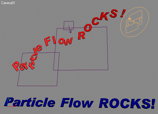

The following example uses a Script Operator to assign a single letter to each particle based on a scene text objects. You can type in any text you want, define the font and change the appearance of the text using modifiers like Extrude and Bevel and let Particle Flow generate a stream of letters showing the text.

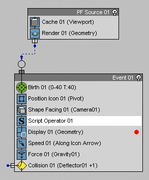

Can Be Used With:
The scripts should be used inside a Script_Operator.

The example uses a unique scene text object (with any modifiers on top) as instanced source.
The script makes copies of the source text and replaces the original text with a single letter from the text.This means that you can create any appearance (like for example adding custom Bevel to the source) and the particle system will inherit these settings.
Changing the Text of the Font of the Source and scrubbing the time back will automatically update the particle system.
Deleted letters from the scene will be detected and the particle system will regenerate to bring them back.
If the source object was removed, a new default text with extrude modifier will be created in the scene with the string "Enter Text Here" and renderable flag set to false. This means that you can start from scratch using this text object and edit its font,text and stack to get the look you want.

You can change the timing of the Birth operator to get more particles if your text is longer than the default
You can use any other PFlow operators to affect the particles. The Script is only responsible for the shape of the particles.
