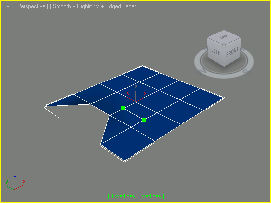

The TVerts Core Interface exposes methods for controlling the T-Vertices xViewChecker which visualizes vertices at T-shaped edgesin Poly objects.
Any vertex with three outgoing edges is considered a T-Vertex regardless of the angle between the edges. T-Vertices are typically found where the flow of an edge loop is interrupted by a full polygon.
