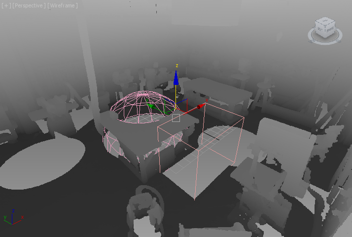

FOR EXAMPLE:
--Create a Point Cloud object at the world origin:
pc = PointCloud()
--> $PointCloud:PointCloud001 @ [0.000000,0.000000,0.000000]
--Load the sample project installed by Autodesk ReCap:
pc.filename = @"C:\ProgramData\Autodesk\Autodesk ReCap\Sample\AutodeskReCapSampleProject.rcp"
--> "C:\ProgramData\Autodesk\Autodesk ReCap\Sample\AutodeskReCapSampleProject.rcp"
--Query the scan files loaded by the project:
pc.scanFiles
--> #("C:\ProgramData\Autodesk\Autodesk Recap\Sample\AutodeskReCapSampleProject Support\techshop_012.rcs", "C:\ProgramData\Autodesk\Autodesk Recap\Sample\AutodeskReCapSampleProject Support\techshop_013.rcs")
--Create some geometry to use as Display Volumes:
s1 = Sphere radius:50 pos:[-50,0,0]
--> $Sphere:Sphere001 @ [-50.000000,0.000000,0.000000]
b1 = Box pos:[-50,-80,0] width:60 length:40 height:50
--> $Box:Box001 @ [-50.000000,-80.000000,0.000000]
pc.VolumeObjects = #(s1,b1)
--> #($Sphere:Sphere001 @ [-50.000000,0.000000,0.000000], $Box:Box001 @ [-50.000000,-80.000000,0.000000])
--Enable the display volumes, invert to cull inside the volumes:
pc.GlobalEnableVolumes = true
--> true
pc.GlobalInvertVolumes = true
--> true
--Increase the quality at cost of performance and increase the pixel point size
pc.performanceQuality = 6
--> 6
pc.asPixelPointSize = 4.0
--> 4.0
--Display using an Elevation ramp map
pc.displayTechnique = 3
--> 3
