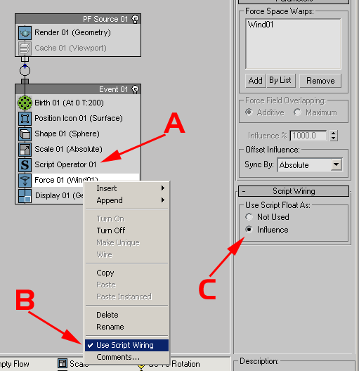

PARTICLE VIEW SETUP : |
The Particle View setup features a Scale operator that defines variable sizes for the particles. To get the Script Wiring, you have to do the following: |

This is the actual code line that calculates an influence value, which is reverse-proportional to the mass of the particle. The result is assigned to the particleFloat channel of the current particle and will be accessed by the Force Operator that has its Script Wiring enabled to accept the Float values from the particleFloat channel.
