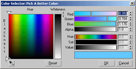

EXAMPLE USAGE:
colorPickerDlg (color 100 200 300) "Pick A Better Color:" alpha:true pos:[100,100]
RESULT:
