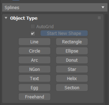

Rectangle : Shape
Rectangle - superclass: shape; super-superclass:node - classID: #(4197, 0)
Value > MAXWrapper > Node > GeometryClass > Shape > Rectangle
Shapes and Splines - Quick Navigation
Constructor
rectangle...
Properties
Parameters Rollout
<Rectangle>.length Float default: 10.0 -- animatable
The size of the rectangle along the local Y axis.
<Rectangle>.width Float default: 25.0 -- animatable
The size of the rectangle along the local X axis.
<Rectangle>.Corner_Radius Float default: 0.0 -- animatable; alias: cornerRadius
Creates rounded corners. When set to 0, the rectangle contains 90-degree corners.
