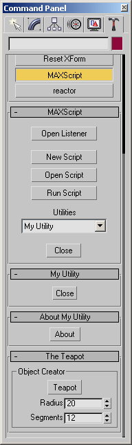

As an example, consider the following script. In this script, line 1 defines the start of the utility, and the utility body is lines 2 through 42. The following line ranges are utility clauses: 3 (a rollout clause), 5 to 9 (a nested rollout), 11 to 30 (a nested rollout), 32 to 35 (a rollout clause), and 37 to 40 (a rollout clause).
SCRIPT |
utility MyUtil "My Utility" ( local pot rollout bout "About My Utility" ( button aboutMU "About" width:45 height:20 on aboutMU pressed do messagebox "My First Utility\nby ME\nVersion .1"\ title:"About My Utility" ) -- end rollout bout rollout creator "The Teapot" ( group "Object Creator" ( button tea "Teapot" spinner rad "Radius" range:[10,50,20] type:#integer spinner seg "Segments" range:[4,32,12] type:#integer scale:1 ) on tea pressed do ( pot=teapot radius:rad.value pot.name="TestPot" pot.segs=seg.value ) -- end on tea pressed on rad changed value do pot.radius=value on seg changed value do pot.segs=seg.value ) -- end rollout creator on MyUtil open do ( addRollout bout addRollout creator ) -- end on MyUtil open on MyUtil close do ( removeRollout bout removeRollout creator ) -- end on MyUtil close ) -- end utility MyUtil |
The Utilities panel rollouts created by the previous script look like the following:
Multiple rollouts defined in a utility
