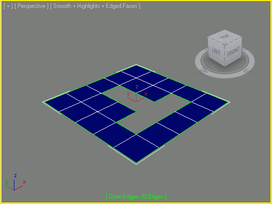

EXAMPLE: |
The following code creates a plane with 5x5 segments, then collapses it to an Editable Poly and deletes some internal polygons in the shape of the letter T, thus creating some more open edges. |

The following call to the OpenEdges.check() method will return the open edges. It does not require the Open Edges Checker to be active in the viewport and can be used in the MAXScript code to acquire the open edges indices into an array or bitarray: |
theResults = #() --we need an array to store the results in
--We call the method by passing the time to check at,
--the object to check and the by-reference array to store
--the results in. The return result of the method itself
--will be #Edge because the method operates on edges
--and the content of theResults array should be threated
--as edge indices:
resultType = openEdges.Check currentTime thePlane &theResults
--> #Edges
--If we would print out the content of the array variable as bitarray,
--it will contain the indices of the open edges as bits set to true:
theResults as bitarray
--> #{1, 4..5, 7..8, 10..11, 13, 15..17, 19..22, 24..25, 29..30, 34..35, 39..41, 45..47, 49, 51, 53, 55..56}
--We can check the number of returned edge indices - it will
--be the same as the count reported by the Open Edges Checker
--in the Viewport:
theResults.count
--> 32
--We could easily select the open edges now:
polyOp.setEdgeSelection thePlane theResults
--> OK
