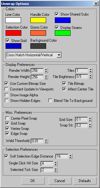

Colors

Fill Mode

Open Edges Display

Display Preferences

Map Tiling

Grid

Hit Size

Tick Size
