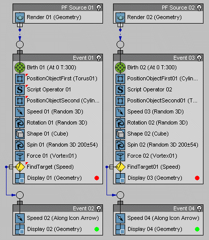

The following sample is based on Laszlo Sebo's VolumeDocking01.max scene and illustrates the following MAXScript operations with Particle Flow :
Common Action creation,
Appending Actions to an Event,
Inserting Actions to an Event,
Cloning Actions and Events
Wiring
Repositioning events in Particle View
Can Be Used With:
The script is self-contained and recreates all objects and Particle Flow Events and Actions on the fly:
Effect:
The script creates two geometry primitives and two PF_Sources with corresponding Actions and Events.
The geometry objects are used as volumes to be filled with particles. The initial positions of the particles are dumped to the particleVector channel. Using a Find_Target action, the particles find their way from the one volume to the other and switch places after swirling around.
