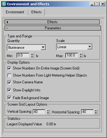

The Lighting_Analysis_Overlay Render Effect allows the generation of lighting analysis data.
Constructors:
Lighting_Analysis_Overlay ...
LightingAnalysisOverlay ...
Properties:
Type and Range
<Lighting_Analysis_Overlay>.quantity Integer default: 0 -- integer
Get/set the index of the Quantity drop-down list selection.
Possible values are:
0 - Illuminance
1 - Luminance
<Lighting_Analysis_Overlay>.scaleType Integer default: 0 -- integer; scale
Get/set the index of the Scale drop-down list selection.
0 - Linear
1 - Logarithmic
<Lighting_Analysis_Overlay>.rangeStart Float default: 0.0 -- animatable; float; quantity_min
Get/set the Range's minimum value.
<Lighting_Analysis_Overlay>.rangeEnd Float default: 100.0 -- animatable; float; quantity_max
Get/set the Range's maximum value.
Display Options
<Lighting_Analysis_Overlay>.shownumbers BooleanClass default: true -- boolean; show_numbers
Get/set the state of the "Show Numbers On Entire Image (Screen Grid)" option.
<Lighting_Analysis_Overlay>.showhelper BooleanClass default: false -- boolean; show_numbers_from_helper_objects
Get/set the state of the "Show Numbers From Light Metering Helper Objects" option.
<Lighting_Analysis_Overlay>.showcameraname BooleanClass default: true -- boolean; show_camera_name
Get/set the state of the "Show Camera Name" option. When set to true, the name of the view/camera will be included in theLighting Analysis Overlay.
<Lighting_Analysis_Overlay>.showdaylightinfo BooleanClass default: true -- boolean; show_daylight_info
Get/set the state of the "Show Daylight Info" option.
<Lighting_Analysis_Overlay>.fadeBackground BooleanClass default: true -- boolean; fade_background
Get/set the state of the "Fade Background Image" option.
Screen Grid Layout Options
<Lighting_Analysis_Overlay>.verticalspacing Integer default: 40 -- animatable; integer; Vertical_spacing
Get/set the Vertical Spacing value.
<Lighting_Analysis_Overlay>.horizontalspacing Integer default: 40 -- animatable; integer; Horizontal_spacing
Get/set the Horizontal Spacing value.
Statistics
<Lighting_Analysis_Overlay>.largestValue Float default: 0.0 -- float
Get the Largest Displayed Value.
