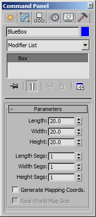

Enter mybox.name = "BlueBox" in the Listener window and the software renames the box.
You can see the new name in the Name edit box when you go to the Modify panel:
By default, 3ds Max assigns the color of objects randomly at creation time. Therefore, the color of your box is not necessarily blue. In this case, BlueBox wouldn’t be an appropriate name for your box. However, you can change the color of your box to match the name:
Enter mybox.wirecolor = blue and watch the box in your viewports turn blue. You may have to select the box again to reflect the new color in the color swatch next to the object name in the Modify panel.

When you scale your original [20,20,20] box by any factor, the box’s parameters are still 20 for width, 20 for length, and 20 for height. You can see this when you open the Modify panel. The box parameters are not changed by the scale transformation:

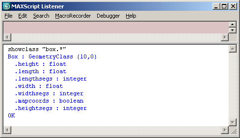

The Parameters rollout shows all the creation parameters for a box. You can change them using the spinners in the rollout. If you want to change the value of the length, width, and height segments, or the setting of the mapping coordinates in MAXScript, you need to know the syntax for these parameters. In order to find the syntax for all of the parameter settings, there are two different inspector functions.
The first of these is showclass().
The showClass() function prints information about a specified 3ds Max class or classes. The information entered in the parentheses is a string containing a wild-card pattern to match against 3ds Max class names, superclass names, and property names.
ENTER: |
showclass "box.*" |
MAXScript shows all the box parameters that are equivalent to the ones you see in the Parameters rollout, including which object class the box object belongs to, and the data type that each parameter requires:
Notice that you can use the "*" character as a wildcard to see all box parameters. If you had entered showClass "box*.*," MAXScript would have listed all of the parameters of theBox and the BoxGizmo classes.
