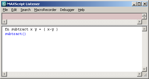

In MAXScript, you can use functions to perform almost any of the software’s operations. Start with a simple function definition that subtracts two variables:
MAXScript returns subtract() to let you know that it has defined the function, subtract.
The definition contains the keyword function (you can also use the word fn in place of function), followed by the name of the function (subtract), followed by the list of variables (x and y). The equal sign signifies the start of the body of the function. The body is the series of statements that the function executes. Even if there is only one statement, the body of the function must be in parentheses.

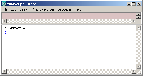

In order to use a function, you simply enter the function name and the values for its variables:
This example uses what are known as positional arguments. When you call the function, you must supply both arguments, and you must supply them in the proper order for the function to execute properly.
