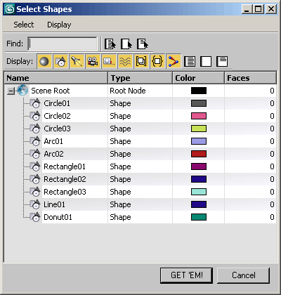

FOR EXAMPLE, |
the following function limits the choices to shape objects: |
fn shape_filt obj = isKindOf obj Shape |
Then you can call the Select By Name function to select multiple shapes including hidden ones: |
theShapes =selectByName title:"Select Shapes" buttonText:"GET 'EM!" filter:shape_filt showHidden:true single:false |
RESULT: |
If the user cancels out of the dialog, the function returns the value undefined .
