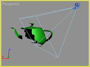

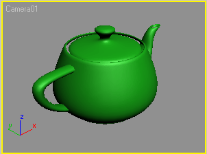

The image on the left shows the teapot with deleted backfaces as seen from a camera viewport. The image on the right shows the teapot and the camera as seen from the side. Note that for the screenshot, the backface culling was disabled (you can see the backfaces on the right image), but the left image looks just like it would with backface culling enabled! This is because the script deletes the same faces the viewport backface culling would skip!
