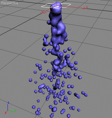

Description:
The following example shows a sample Metaball script using the Parray particle system.
Can Be Used With:
Should be used in a Script_Operator.
Effect:
In the Proceed handler, a new Mesh object is created with a vertex at each particle. Then, a PArray classical particle system is created and used to generate a metaball mesh out of all vertices of the supplied mesh. Now, using a Mesher compound object, a snapshot of the metaball is made and used as the shape of the first particle.
