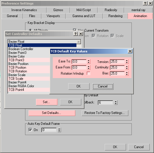

The TCBDefaultParams Structure allows you to set the default TCB key parameters to be used for newly created TCB controller keys.
Available in 3ds Max 2008 and higher. Previously available in the free Avguard Extensions.
Properties:
TCBDefaultParams.tension
Get/set the default TCB key tension.
TCBDefaultParams.continuity
Get/set the default TCB key continuity.
TCBDefaultParams.bias
Get/set the default TCB key bias.
TCBDefaultParams.easeTo
Get/set the default TCB key easeTo value.
TCBDefaultParams.easeFrom
Get/set the default TCB key easeFrom value.
