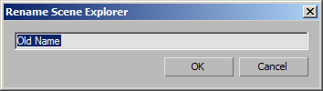

This dotNetObject is implemented by the MaxCustomControls Assembly and provides a DotNet Form with a TextBox for renaming instances of the Scene Explorer. It features the 3ds Max Look-And-Feel including the current color scheme, 3ds Max icon, and others.
EXAMPLE |
theObj = dotNetObject "MaxCustomControls.RenameInstanceDialog" "Old Name" theObj.Show() |
