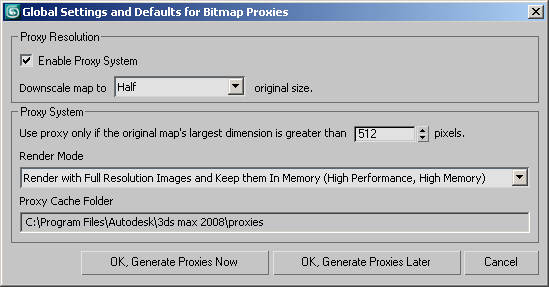

BitmapProxyMgr.globalProxyEnable : boolean : Read|Write
Enables Bitmap Proxies globally.Corresponds to the "Enable Proxy System" checkbox in the Bitmap Proxies dialog.
BitmapProxyMgr.globalProxyRenderMode : enum : Read|Write
globalProxyRenderMode enums: {#renderMode_UseProxies | #renderMode_UseFullRes_KeepInMemory | #renderMode_UseFullRes_FlushFromMemory}
Gets/Sets the global Proxy Render Mode. Corresponds to the Render Mode drop-down list in the Bitmap Proxies dialog.
BitmapProxyMgr.globalProxySizeFactor : enum : Read|Write
globalProxySizeFactor enums: {#full|#half|#third|#quarter|#eighth}
Gets/Sets the global Proxy Size Factor. Corresponds to the "Downscale map to..." drop-down list in the Bitmap Proxies dialog.
BitmapProxyMgr.globalProxySizeMin : integer : Read|Write
Gets/Sets the global Proxy minimum size in pixels. Corresponds to the "pixels" spinner in the Bitmap Proxies dialog.

<void>BitmapProxyMgr.ShowConfigDialog bitmapFielnames :<string array> bitmapFielnames default value: #()
Opens the Bitmap Proxies configuration dialog.
If the optional bitmap Filenames argument is #() or not supplied, the dialog will be titled "Global Settings and Defaults for Bitmap Proxies" and will affect all bitmaps globally.
If it contains a list of bitmap filenames, the dialog will be titled "Per-Bitmap Resolution for Bitmap Proxies" and the settings will apply to the specified bitmaps only.
