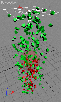

The script goes through all particles, compares the particle position with a radius of 20 and sets the particle’s test status to true when the particle is inside the radius.

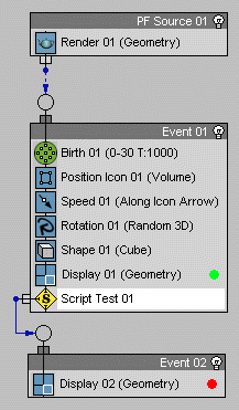

In the above setup, the particles that pass through the sphere are sent to the next event where they change their color:
