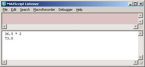

Enter 36.5 * 2, for example, to see what a certain dimension needs to be if you want to double it.
MAXScript returns the result of the calculation. This is useful for quick calculations where loading an external calculator program doesn’t seem worth the trouble.

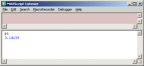

MAXScript also recognizes several mathematical constants. Enter pi.
MAXScript knows the value of pi and returns it.

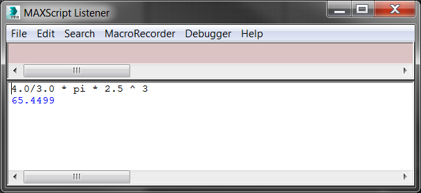

You can use this value in more complex operations. For example, if you want to know the volume of a sphere with a 2.5-inch radius, multiply the cube of the radius by pi, then multiply by 4.0 and divide by 3.0. Enter 4.0/3.0 * pi * 2.5^3.

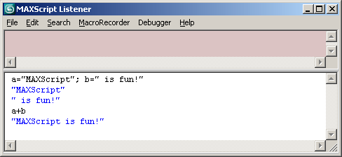

You can also perform some simple mathematical operations with strings. For example, if you have defined a="MAXScript" and b=" is fun!", entering a+b returns "MAXScript is fun!"
For more string operations, see the String Values topic in the MAXScript reference.

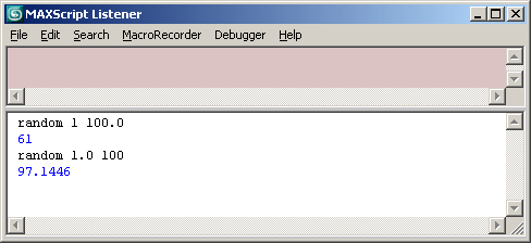

One very useful mathematical operation in MAXScript is the random number function. It returns a pseudo-random number selected inclusively between two user-specified arguments.
EXAMPLE |
random 1 100 |
returns a random integer between 1 and 100. The return value type (Float or Integer) is the same as the type of the first argument in the function, therefore if you enter |
random 1.0 100 |
MAXScript returns a random float between 1.0 and 100.0 |
seed <number>where <number> is any float or integer. Each time you change the seed value, MAXScript generates a new set of "random" numbers.
