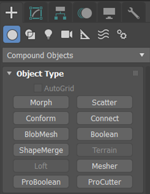

The Boolean3 / BooleanObject2 Compound Object Classes let you create compound Boolean objects. Available in 3ds Max 2017 and higher.
