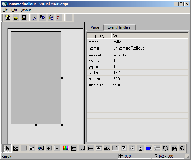

When you first edit or create a rollout in the layout editor, it defaults to the standard width for Command Panel rollouts. You can adjust this width in the editor by resizing the outer gray rectangle and the editor emits width: and height: parameters on the generated rollout header. You can edit these numbers in the script editor and they will be honored by the layout editor when you next edit that rollout.

You add new UI items by clicking its button in the item toolbar at the bottom and then dragging out a rectangle for it in the main form. You can select an existing item and edit its parameters in the property list on the right. You can select multiple items by fence-dragging or ctrl-clicking and perform various alignments operations, see the Layout menu. A selected item can be deleted by clicking the red X toolbar button. The various panes can be resized or even torn off if you want to customize the editor layout.
