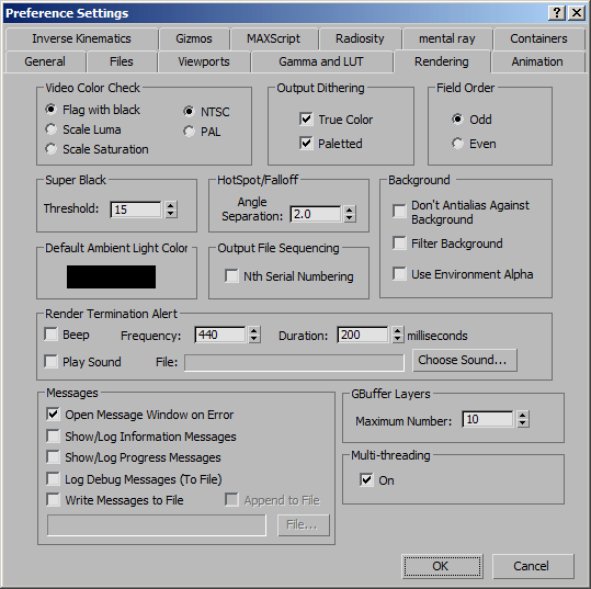

Renderer Preferences
Lighting And Rendering - Quick Navigation
rendVidCorrectMethod -- integer
Get/set the video color check method.
Possible values are:
1 - Flag with black
2 - Scale Luma
3 - Scale Saturation
rendNTSC_PAL -- integer
Get/set the video color check NTSC or PAL setting.
1 - NTSC
2 - PAL
rendDitherTrue -- boolean
Get/set the renderer's dither true color flag. TRUE = on; FALSE = off
rendDither256 -- boolean
Get/set the renderer's dither 256 color flag. TRUE = on; FALSE = off
rendFieldOrder -- integer
Get/set the rendering field order.
1 - Even
2 - Odd
rendSuperBlackThresh -- integer
Get/set the Super Black Threshold value. Range 0 to 255. Default is 15.
rendNThSerial -- boolean
Get/set the output file sequencing nth serial numbering setting. TRUE = on; FALSE = off
preferences.maximumGBufferLayers
Get/set an Integer value that specifies the maximum number of g-buffer layers generated during a render.
rendMultiThread -- boolean
Get/set the renderer's multi-threaded flag. TRUE = on; FALSE = off
