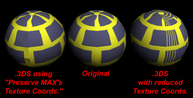

You can visualize this by creating a Sphere with texture coordinates and exporting to .3DS without preserving the texture coordinates. The number of texture vertices will be reduced to fit the old format. Read back the .3DS file, apply the same material to both objects (original Sphere and imported mesh) and compare the mapping:
What does the Preserve Max Texure Coordinates checkbox in the 3DS Exporter do? It duplicates the mesh vertices to achieve the one-to-one correspondence required by the .3DS format. This means that the pole vertex of a sphere will be split into multiple vertices, one for each face referencing it and using a different texture vertex. While this will preserve the coordinates, it destroys part of the mesh smoothing as there can be no smoothing between elements not sharing common vertices/edges. (see left sphere on the image)
