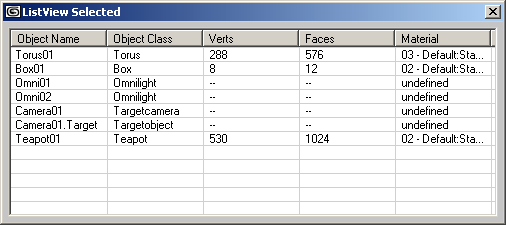

This tutorial will demonstrate how to set up an ActiveX Control in a MAXScript rollout to display details about selected scene objects.

Select some scene objects and press the button/select the menu item or press the keyboard shortcut - a new dialog with a listView ActiveX control displaying the name, class, vertex and face count and assigned material should appear.
Select some other object and call the script again - the old dialog will be closed, a new one will be opened and will display the data of the new selection.
