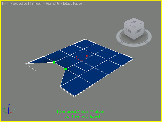

The OverlappingVertices Core Interface exposes methods for interacting with the Overlapping Vertices xView Checker.

Performs an Overlapping Vertices xView check at the given time on the specified node and returns its results in the array passed by-reference as third argument.
The method itself always returns the #vertices enum because the values written to the results array always represent the indices of overlapping vertices.
