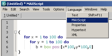

The Language menu of the Tabbed MAXScript Editor introduced in 3ds Max 2008 contains commands for switching the syntax coloring between the currently installed modes:
Text(SHIFT+F11)- no syntax coloring
MAXScript- default for .ms and .mcr files
Properties- default for .properties files
Hypertext- default for HTML files
XML- default for XML files
