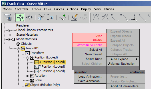

The LockedTracksMan Core Interface available in 3ds Max 2010 and higher exposes properties and methods related to animation track locking.
Properties:
LockedTracksMan.unLockOverride : bool : Read|Write
Get/Set the state of the Override All Locks option.
When set to true, the locked state of locked tracks will be temporarily overridden and their values can be changed.
When set to false, the values of locked tracks cannot be changed.
