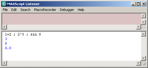

MAXScript also lets you combine multiple statements and expressions in a single line. The statements or expressions are separated with a ’;’
FOR EXAMPLE: |

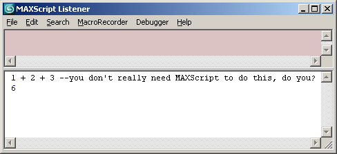

Sometimes it is useful to enter comments within your script to provide guidance or context. You can enter comments in MAXScript by preceding your comment with a double-hyphen --. As soon as MAXScript reaches the double-hyphen, it stops evaluating the rest of that line.
FOR EXAMPLE: |
