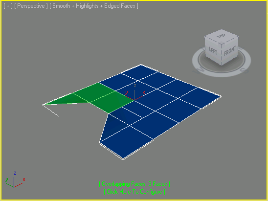

The OverlappingFaces Core Interface exposes methods for interacting with the Overlapping Faces xView Checker.
Available in 3ds Max 2010 and higher.
Properties:
OverlappingFaces.tolerance : float : Read|Write
Get/set the tolerance value of the Overlapping Faces check. Corresponds to the value set in the Properties dialog of the test.
Methods:
<enum>OverlappingFaces.Check <time>time <node>nodeToCheck <&index array>results
Check enums: {#Failed|#Vertices|#Edges|#Faces}
results is In and Out parameter
Performs an Overlapping Faces xView check at the given time on the specified node and returns its results in the array passed by-reference as third argument.
The method itself always returns the #faces enum because the values written to the results array always represent indices of overlapping faces.
