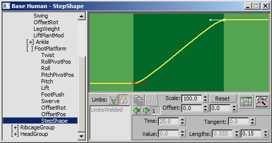

This is a CATMotion Controller responsible for the shape of the step in 3ds Max CAT.

Lift Tangent
<CATStepShape>.LiftTangent : float
Get/set the Lift Tangent value.
<CATStepShape>.LiftOutTanLen (LiftTanLen) : float
Get/set the Lift Out Tangent Length value.
Plant Tangent
<CATStepShape>.PlantTangent : float
Get/set the Plant Tangent value.
<CATStepShape>.PlantInTanLen (PlantTanLen) : float
Get/set the Plant In Tangent Length value.
