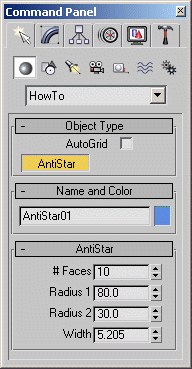

rollout params "AntiStar"
spinner num_faces "# Faces" range:[2,100,10] type:#integer
spinner radius1 "Radius 1" range:[0,10000,0]
spinner radius2 "Radius 2" range:[0,10000,0]
spinner width "Width" range:[0,90,1]
Now, you can provide the rollout with UI elements referenced by the Parameter Block. The UI elements can limit the input values using the optional range: parameter, but the default value is taken from the ParamBlock2.

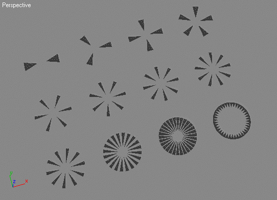

Using the Script
This is a scripted plug-in and it is handled by 3ds Max as a real C++ plug-in.
To install it permanently on your system, copy the file to the \plugins folder or to any other folder listed in the plug-in paths.
To try the plug-in without installing it permanently, evaluate the code and look under Create panel>Geometry>HowTo category in the drop-down list. The plug-in is only available for the single session and will not be there after restarting 3ds Max.
Any MAX files saved with the plug-in in the scene will require the script to be installed and evaluated in order to load correctly.
To use the plug-in, click the AntiStar button in the Create panel > Geometry > HowTo. Click in the viewport to define the center, drag to define the outer radius, click and drag again to define the inner radius, and click and drag again to define the width. Click to finish or right-click to cancel.
Play with the controls in the UI under the Modify panel and note how quickly the mesh is updated by the script.
