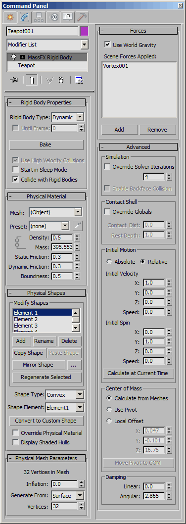

<MassFX_RBody>.type Integer default: 1 -- integer; None
Gets/sets the state of the "Rigid Body Type" drop-down list.
Possible values are:
1 - Dynamic (default) - the Rigid Body is driven by the simulation. It is applied gravitational forces, participates in and reacts to collisions with other Rigid Bodies, and so on. Its Rigid Body Mesh cannot be concave.
2 - Kinematic - the Rigid Body is driven by pre-defined (usually keyframed) animation and can drive Dynamic Rigid Bodies, but is otherwise unaffected by the physics simulation. Its Rigid Body Mesh cannot be concave.
3 - Static - the Rigid Body is unyielding and can interact with Dynamic Rigid Bodies, but cannot be animated. Its Rigid Body Mesh can be concave.
<MassFX_RBody>.switchType BooleanClass default: false -- boolean; None
Gets/sets the state of the "Until Frame" checkbox. When set to true, the type of the Rigid Body can be switched from Kinematic to Dynamic at a specified frame provided by the .switchTypeAtFrame property.
<MassFX_RBody>.switchTypeAtFrame Integer default: 0 -- integer; None
Gets/sets the frame on which the Rigid Body will be switched from Kinematic to Dynamic if the .switchType property is set to true.
<MassFX_RBody>.baked Integer default: 0 -- integer; None
Gets/sets the state of the "Bake/Unbake" button. When baked, the animation of a Dynamic Rigid Body will be converted to keyframes.
0 - Unbaked - setting the property to 0 will unbake the Rigid Body and switch the button's caption to "Bake".
1 - Baked - setting the property to 1 will bake the Rigid Body and switch the button's caption to "Unbake".
<MassFX_RBody>.ContinuousCollisionDetection BooleanClass default: false -- boolean; None
Gets/sets the state of the "Use High Velocity Collisions" option.
If set to true and the global High Velocity Collisions switch in the MassFX World panel is enabled, the Dynamic Rigid Body will perform continuous collision detection.
<MassFX_RBody>.SleepAtStart BooleanClass default: false -- boolean; None
Gets/sets the state of the "Start In Sleep Mode" option.
When set to true, the Dynamic Rigid Body will be placed in sleep mode at the start of the simulation using the global sleep mode settings. This means that it will not move until struck by a non-sleeping Rigid Body.
<MassFX_RBody>.CollideWithRigidBodies BooleanClass default: true -- boolean; None
Gets/sets the state of the "Collide With Ridig Bodies" option.
When set to true, the Rigid Body will collide with other Rigid Bodies. When set to false, the Rigid Body will not participate in collisions.
Properties:
<MassFX_RBody>.density Float default: 0.5 -- float; None
Gets/sets the Density value of the Rigid Body. The Density is measured in grams per cubic centimeter. Changing this value automatically calculates the correct mass for the object based on its volume.
<MassFX_RBody>.mass Float default: 1.0 -- float; None
Gets/sets the Mass of the Rigid Body measured in kilograms.
<MassFX_RBody>.staticFriction Float default: 0.3 -- float; None
Gets/sets the Static Friction value of the Rigid Body's Physical Material.
Static Friction is the degree of difficulty for two Rigid Bodies to start sliding against one another. A value of 0.0 indicates no friction, a value of 1.0 indicates full friction. The effective static friction between two rigid bodies is the product of their static friction values. If one rigid body has a static friction of 0.0, the value of the other rigid body does not matter (everything slides on wet ice; even sandpaper). Once the two objects start sliding, the Dynamic Friction (see below) applies.
<MassFX_RBody>.dynamicFriction Float default: 0.3 -- float; None
Gets/sets the Dynamic Friction value of the Physical Material.
Dynamic Friction is the degree of difficulty for two rigid bodies to keep sliding against one another. Technically, this parameter is called the "coefficient of kinematic friction." A value of 0.0 indicates no friction, a value of 1.0 indicates full friction. In the real world, this value must be less than the coefficient of static friction - it is harder to start pushing an object than to keep it moving. As with static friction, the effective value between two rigid bodies is the product of their respective values.
<MassFX_RBody>.bounciness Float default: 0.5 -- float; None
Gets/sets the Bounciness value of the Rigid Body's Physical Material.
This value controls how an object bounces when it hits another rigid body. Technically, this parameter is called the "coefficient of restitution." A value of 0.0 indicates no bounce, a value of 1.0 indicates that the object will bounce off just about as hard as it hit. The effective bounciness between two rigid bodies is the product of their bounciness values.
Methods:
<boolean><MassFX_RBody>.SetRBPresetMaterial <integer>materialID
Available in 3ds Max 2013 and higher.
Properties:
<MassFX_RBody>.meshType Integer default: 4 -- integer; None
1 - Sphere
2 - Box
3 - Capsule
4 - Convex (default)
5 - Convex
6 - Custom
7 - Concave
<MassFX_RBody>.meshOverrideMaterial BooleanClass default: true -- boolean; None;

<MassFX_RBody>.EnableGravity BooleanClass default: true -- boolean; None
Gets/sets the state of the "Use Gravity" option.
If set to true and if the global Gravity switch in the MassFX World panel is enabled, the Dynamic Rigid Body will be affected by Gravity.
<MassFX_RBody>.forcesList : node array
Gets/sets the array of Force SpaceWarp objects associated with the MassFX Rigid Body simulation.
Array operations like append() and deleteItem() are supported.

<MassFX_RBody>.EnableAdvancedSettings Integer default: 1 -- integer
Properties:
<MassFX_RBody>.SolverIter BooleanClass default: false -- boolean; None
Gets/sets the state of the "Override Solver Iterations" checkbox.
When set to False (default), the global Iterations count will be used.
When set to True, the MassFX Rigid Body modifier will use the custom number of iterations specified by the .SolverIterValue property (see below).
<MassFX_RBody>.SolverIterValue Integer default: 4 -- integer; None
Gets/sets the "Override Solver Iterations" value that is used when the MassFX Rigid Body Modifier's .SolverIter property (see above) is set to True.
<MassFX_RBody>.EnableBackfaceCollision : boolean
Gets/sets whether to use Backface Collision or not.
Default is false.
Methods:
Properties:
Methods:
Properties:
<MassFX_RBody>.InitialMotionStyle Integer default: 1 -- integer
Gets/sets the state of the Initial Motion Style radio buttons.
0 - Absolute
1 - Relative
<MassFX_RBody>.InitialVelocityX Float default: 1.0 -- float; None
<MassFX_RBody>.InitialVelocityY Float default: 0.0 -- float; None
<MassFX_RBody>.InitialVelocityZ Float default: 0.0 -- float; None
Gets/sets the Initial Velocity X, Y, and Z values of the Rigid Body. These define the direction of the initial velocity.
<MassFX_RBody>.velocitySpeed Float default: 0.0 -- float; None
Gets/sets the Initial Velocity's Speed value of the Rigid Body. This defines the magnitude of the Initial Velocity.
<MassFX_RBody>.InitialSpinX Float default: 0.0 -- float; None
<MassFX_RBody>.InitialSpinY Float default: 1.0 -- float; None
<MassFX_RBody>.InitialSpinZ Float default: 0.0 -- float; None
Gets/sets the Initial Spin X, Y, and Z values of the Rigid Body. These define the axis of the initial spin.
<MassFX_RBody>.spinSpeed Float default: 0.0 -- float; None
Gets/sets the Initial Spin's Speed value of the Rigid Body.

<MassFX_RBody>.MassCenterMode : integer
Gets/sets the state of the Center Of Mass radio buttons.
Valid values are:
0 - Calculate from Meshes
1 - Use Pivot
2 - Local Offset
<MassFX_RBody>.MassCenterX Float default: 0.0 -- float; None
<MassFX_RBody>.MassCenterY Float default: 0.0 -- float; None
<MassFX_RBody>.MassCenterZ Float default: 0.0 -- float; None
Gets/sets the X, Y, and Z coordinates of the Rigid Body's Center Of Mass in object space.
See the method .CalculateMassCenter() below for setting these values automatically based on the Rigid Body's meshes.
Methods:
<Point3><MassFX_RBody>.CalculateMassCenter()
Calculates the Center Of Mass and sets the properties .MassCenterX , .MassCenterY , and .MassCenterZ . Returns the result as a Point3 value.
Properties:
<MassFX_RBody>.LinearDamping Float default: 0.0 -- float; None
Gets/sets the Linear Damping value.
<MassFX_RBody>.AngularDamping Float default: 2.86479 -- float; None
Gets/sets the Angular Damping value.
