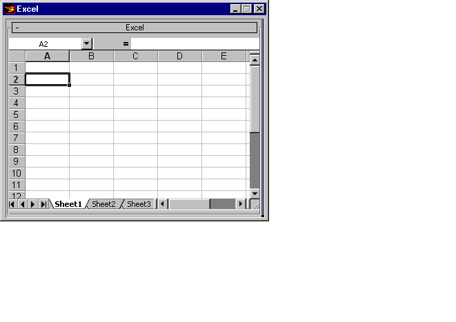

Creates a Microsoft Excel spreadsheet inside an embedded Microsoft Internet Explorer browser control. It also registers the rollout as an extended viewport -
SAMPLE SCRIPT |
rollout rExcel "Excel" ( activeXControl ax "e:\\test.xls" height:250 width:370 align:#center ) fExcel = newRolloutFloater "Excel" 390 270 addRollout rExcel fExcel format "----Application----" showProperties rExcel.ax.application format "----Parent----" showProperties rExcel.ax.parent format "----Container----" showProperties rExcel.ax.container -- In case of MS Excel .document points to the msexcel.workbook workbook = rExcel.ax.document format "----Document----" showProperties workbook showHidden:true showMethods workbook showHidden:false props = getPropNames workbook sort props for prop in props do ( try ( format "\t%=%\n" (prop as string) (getProperty workbook prop) ) catch () ) |
