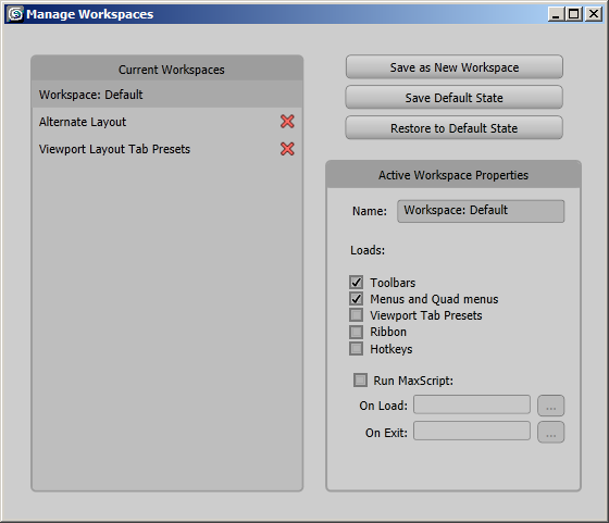

The WorkspaceManager Core Interface exposes the features of the Manage Workspaces dialog to MAXScript.

<bool>WorkspaceManager.IsSystemWorkspace <string>identifier
Returns True if the Workspace specified by the given identifier is a system workspace, False if it is not.
