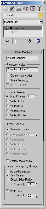

The Project_MappingReferenceTarger is used as a "plug-in" for the Projection : Modifier. It implements the basic projection of mapping coordinates between geometry objects with dissimilar topology.
Properties
<Project_Mapping>.name: string
Get/Set the name of the Projection.
<Project_Mapping>.holderName (Projection_Holder_Name) : string
Get/Set the name of the corresponding Project_Mapping_Holder.
<Project_Mapping>.createNewHolder (Create_New_Holder) : boolean
Get/Set the state of the "Create New Holder" checkbox.
<Project_Mapping>.sameTopology (Same_Topology) : boolean
Get/Set the state of the "Same Topology" checkbox.
<Project_Mapping>.alwaysUpdate (Always_Update_Holder) : boolean
Get/Set the state of the "Always Update " checkbox.
<Project_Mapping>.sourceMapChannel (Source_Map_Channel) : integer
Get/Set the source map channel.
<Project_Mapping>.sameAsSource (Same_as_Source) : boolean
Get/Set the state of the "Same as Source" checkbox.
When true , the .sourceMapChannel value will be used for both Source and Target.
<Project_Mapping>.targetMapChannel (Target_Map_Channel) : integer
Get/Set the target map channel.
<Project_Mapping>.projectMaterialIDs (Project_Material_IDs) : boolean
Get/Set the state of the "Project Material IDs" checkbox.
<Project_Mapping>.ignoreBackfacing (Ignore_Backfacing) : boolean
When set to true , backfaces will be ignored.
Corresponds to the "Ignore Backfacing" checkbox in the "Projection Quality" group of controls.
Default is false.
<Project_Mapping>.testSeams (Test_Seams) : boolean
When set totrue, seams will be checked.
Corresponds to the "Test Seams" checkbox in the "Projection Quality" group of controls.
Default is true.
Available in3ds Max 2008 and higher.
<Project_Mapping>.checkEdgeRatios (Check_Edge_Ratios) : boolean
When set totrue, edge ratios will be checked.
Corresponds to the "Check Edge Ratios" checkbox in the "Projection Quality" group of controls.
Default is false.
<Project_Mapping>.edgeRatioThreshold (Edge_Ratio_Threshold) : float
Get/set the Edge Ratio Threshold.
Corresponds to the "Check Edge Ratios>Threshold" spinner in the "Projection Quality" group of controls.
Default is 0.1.
<Project_Mapping>.weldUVs (Weld_UVs) : boolean
When set to true , UVs will be welded based on the threshold defined by .weldUVsThreshold .
Corresponds to the "Weld UVs" checkbox in the "Projection Quality" group of controls.
Default is true .
<Project_Mapping>.weldUVsThreshold (Weld_UVs_Threshold) : float
Get/set the UV Welding Threshold.
Corresponds to the "Weld UVs>Threshold" spinner in the "Projection Quality" group of controls.
Default is 5.0.
