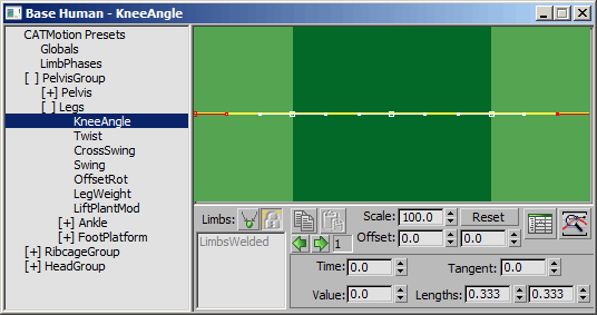

 <CATKneeAngle>.LimbData (CATLimbData) : maxObject
Contains the LimbData controller object.
Lift Knee Angle
 <CATKneeAngle>.LiftValue : float
Get/set the Lift Knee Angle value.
 <CATKneeAngle>.LiftTangent : float
Get/set the Lift Tangent value.
 <CATKneeAngle>.LiftInTanLength (LiftInTanLen) : float
Get/set the Lift In Tangent Length value.
 <CATKneeAngle>.LiftOutTanLength (LiftOutTanLen) : float
Get/set the Lift Out Tangent Length value.
