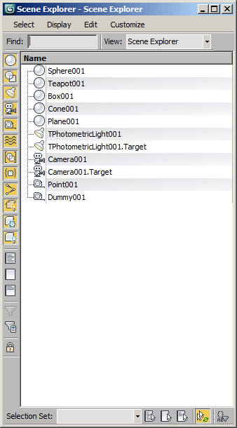

dotNetObject "MaxCustomControls.SceneExplorerControls.SceneExplorerDialog"
This dotNetObject implements the modeless Scene Explorer dialog form.
EXAMPLE |
theFrm = dotNetObject "MaxCustomControls.SceneExplorerControls.SceneExplorerDialog" thePtr = DotNetObject "System.IntPtr" (windows.getMAXHWND()) theHwnd = (dotNetObject "System.Windows.Forms.NativeWindow").FromHandle thePtr theFrm.Show(theHwnd) |

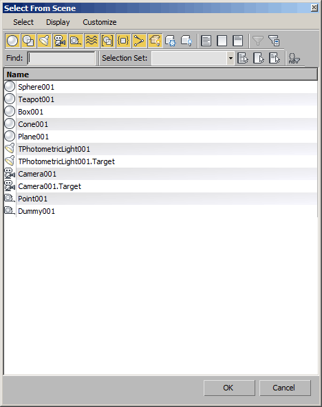

dotNetObject "MaxCustomControls.SceneExplorerControls.ModalSceneExplorerDialog"
This dotNetObject implements the modal Scene Explorer dialog form. Note that it does not block the main 3ds Max thread when opened and requires event handlers to be registered to be fully functional (e.g. return a selected object).
EXAMPLE |
theFrm = dotNetObject "MaxCustomControls.SceneExplorerControls.ModalSceneExplorerDialog" thePtr = DotNetObject "System.IntPtr" (windows.getMAXHWND()) theHwnd = DotNetObject "MaxCustomControls.Win32HandleWrapper" thePtr theFrm.Show(theHwnd) |
Constructors:
MaxCustomControls.SceneExplorerControls.ModalSceneExplorerDialog() MaxCustomControls.SceneExplorerControls.ModalSceneExplorerDialog <ExplorerFramework.DataFacade>aFacade
