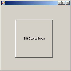

DotNet controls cannot only be placed inside 3ds Max Dialogs and Rollouts, but they can also be used to generate user interfaces implemented completely using DotNet Forms.
In the following example, a DotNet Button is created and assigned to a DotNet Form including a custom function declared as an event handler. Finally, the Form is displayed as a dialog by calling its .show() method.
SCRIPT |
( fn whenButtonIsPressed a b = ( format "Pressed from a DotNet Button\n" format "Argument a (Form): <%> \n" (classof a) format "Properties:\n" showproperties a format "Methods:\n" showmethods a format "Events:\n" showevents a format "\nArgument b (Button): <%> \n" (classof b) format "Properties:\n" showproperties b format "Methods:\n" showmethods a format "Events:\n" showevents a ) --Create a DotNet Button mButton = dotNetObject "System.Windows.Forms.Button" mButton.text = "BIG DotNet Button" mButton.size = dotNetObject "System.Drawing.Size" 160 160 mButton.location = dotNetObject "System.Drawing.Point" 60 60 --Create a DotNet Form hForm = dotNetObject "System.Windows.Forms.Form" hForm.controls.add mButton --add the Button to the Form hForm.topmost = true --Add an Event Handler for the click event: dotNet.addEventHandler mButton "click" whenButtonIsPressed hForm.show() --show the Form with the Button ) |
Output Of The Event Handler When Button Is Pressed: |
Pressed from a DotNet Button Argument a (Form): <dotNetObject> Properties: .AccessibilityObject : <System.Windows.Forms.AccessibleObject>, read-only .AccessibleDefaultActionDescription : <System.String> .AccessibleDescription : <System.String> .AccessibleName : <System.String> .AccessibleRole : <System.Windows.Forms.AccessibleRole> .AllowDrop : <System.Boolean> .Anchor : <System.Windows.Forms.AnchorStyles> .AutoEllipsis : <System.Boolean> .AutoScrollOffset : <System.Drawing.Point> .AutoSize : <System.Boolean> .AutoSizeMode : <System.Windows.Forms.AutoSizeMode> .BackColor : <System.Drawing.Color> .BackgroundImage : <System.Drawing.Image> .BackgroundImageLayout : <System.Windows.Forms.ImageLayout> .BindingContext : <System.Windows.Forms.BindingContext> .Bottom : <System.Int32>, read-only .Bounds : <System.Drawing.Rectangle> .CanFocus : <System.Boolean>, read-only .CanSelect : <System.Boolean>, read-only .Capture : <System.Boolean> .CausesValidation : <System.Boolean> .CheckForIllegalCrossThreadCalls : <System.Boolean>, static .ClientRectangle : <System.Drawing.Rectangle>, read-only .ClientSize : <System.Drawing.Size> .CompanyName : <System.String>, read-only .Container : <System.ComponentModel.IContainer>, read-only .ContainsFocus : <System.Boolean>, read-only .ContextMenu : <System.Windows.Forms.ContextMenu> .ContextMenuStrip : <System.Windows.Forms.ContextMenuStrip> .Controls : <System.Windows.Forms.Control+ControlCollection>, read-only .Created : <System.Boolean>, read-only .Cursor : <System.Windows.Forms.Cursor> .DataBindings : <System.Windows.Forms.ControlBindingsCollection>, read-only .DefaultBackColor : <System.Drawing.Color>, read-only, static .DefaultFont : <System.Drawing.Font>, read-only, static .DefaultForeColor : <System.Drawing.Color>, read-only, static .DialogResult : <System.Windows.Forms.DialogResult> .DisplayRectangle : <System.Drawing.Rectangle>, read-only .Disposing : <System.Boolean>, read-only .Dock : <System.Windows.Forms.DockStyle> .Enabled : <System.Boolean> .FlatAppearance : <System.Windows.Forms.FlatButtonAppearance>, read-only .FlatStyle : <System.Windows.Forms.FlatStyle> .Focused : <System.Boolean>, read-only .Font : <System.Drawing.Font> .ForeColor : <System.Drawing.Color> .Handle : <System.IntPtr>, read-only .HasChildren : <System.Boolean>, read-only .Height : <System.Int32> .Image : <System.Drawing.Image> .ImageAlign : <System.Drawing.ContentAlignment> .ImageIndex : <System.Int32> .ImageKey : <System.String> .ImageList : <System.Windows.Forms.ImageList> .ImeMode : <System.Windows.Forms.ImeMode> .InvokeRequired : <System.Boolean>, read-only .IsAccessible : <System.Boolean> .IsDisposed : <System.Boolean>, read-only .IsHandleCreated : <System.Boolean>, read-only .IsMirrored : <System.Boolean>, read-only .LayoutEngine : <System.Windows.Forms.Layout.LayoutEngine>, read-only .Left : <System.Int32> .Location : <System.Drawing.Point> .Margin : <System.Windows.Forms.Padding> .MaximumSize : <System.Drawing.Size> .MinimumSize : <System.Drawing.Size> .ModifierKeys : <System.Windows.Forms.Keys>, read-only, static .MouseButtons : <System.Windows.Forms.MouseButtons>, read-only, static .MousePosition : <System.Drawing.Point>, read-only, static .Name : <System.String> .Padding : <System.Windows.Forms.Padding> .Parent : <System.Windows.Forms.Control> .PreferredSize : <System.Drawing.Size>, read-only .ProductName : <System.String>, read-only .ProductVersion : <System.String>, read-only .RecreatingHandle : <System.Boolean>, read-only .Region : <System.Drawing.Region> .Right : <System.Int32>, read-only .RightToLeft : <System.Windows.Forms.RightToLeft> .Site : <System.ComponentModel.ISite> .Size : <System.Drawing.Size> .TabIndex : <System.Int32> .TabStop : <System.Boolean> .Tag : <System.Object> .Text : <System.String> .TextAlign : <System.Drawing.ContentAlignment> .TextImageRelation : <System.Windows.Forms.TextImageRelation> .Top : <System.Int32> .TopLevelControl : <System.Windows.Forms.Control>, read-only .UseCompatibleTextRendering : <System.Boolean> .UseMnemonic : <System.Boolean> .UseVisualStyleBackColor : <System.Boolean> .UseWaitCursor : <System.Boolean> .Visible : <System.Boolean> .Width : <System.Int32> .WindowTarget : <System.Windows.Forms.IWindowTarget> Methods: .<System.IAsyncResult>BeginInvoke <System.Delegate>method .<System.IAsyncResult>BeginInvoke <System.Delegate>method <System.Object[]>args .BringToFront() .<System.Boolean>Contains <System.Windows.Forms.Control>ctl .CreateControl() .<System.Drawing.Graphics>CreateGraphics() .<System.Runtime.Remoting.ObjRef>CreateObjRef <System.Type>requestedType .Dispose() .<System.Windows.Forms.DragDropEffects>DoDragDrop <System.Object>data <System.Windows.Forms.DragDropEffects>allowedEffects .DrawToBitmap <System.Drawing.Bitmap>bitmap <System.Drawing.Rectangle>targetBounds .<System.Object>EndInvoke <System.IAsyncResult>asyncResult .<System.Boolean>Equals <System.Object>obj .[static]<System.Boolean>Equals <System.Object>objA <System.Object>objB .<System.Windows.Forms.Form>FindForm() .<System.Boolean>Focus() .[static]<System.Windows.Forms.Control>FromChildHandle <System.IntPtr>handle .[static]<System.Windows.Forms.Control>FromHandle <System.IntPtr>handle .<System.Windows.Forms.Control>GetChildAtPoint <System.Drawing.Point>pt .<System.Windows.Forms.Control>GetChildAtPoint <System.Drawing.Point>pt <System.Windows.Forms.GetChildAtPointSkip>skipValue .<System.Windows.Forms.IContainerControl>GetContainerControl() .<System.Int32>GetHashCode() .<System.Object>GetLifetimeService() .<System.Windows.Forms.Control>GetNextControl <System.Windows.Forms.Control>ctl <System.Boolean>forward .<System.Drawing.Size>GetPreferredSize <System.Drawing.Size>proposedSize .<System.Type>GetType() .Hide() .<System.Object>InitializeLifetimeService() .Invalidate() .Invalidate <System.Drawing.Rectangle>rc .Invalidate <System.Drawing.Region>region .Invalidate <System.Boolean>invalidateChildren .Invalidate <System.Drawing.Region>region <System.Boolean>invalidateChildren .Invalidate <System.Drawing.Rectangle>rc <System.Boolean>invalidateChildren .<System.Object>Invoke <System.Delegate>method .<System.Object>Invoke <System.Delegate>method <System.Object[]>args .[static]<System.Boolean>IsKeyLocked <System.Windows.Forms.Keys>keyVal .[static]<System.Boolean>IsMnemonic <System.Char>charCode <System.String>text .NotifyDefault <System.Boolean>value .PerformClick() .PerformLayout() .PerformLayout <System.Windows.Forms.Control>affectedControl <System.String>affectedProperty .<System.Drawing.Point>PointToClient <System.Drawing.Point>p .<System.Drawing.Point>PointToScreen <System.Drawing.Point>p .<System.Windows.Forms.PreProcessControlState>PreProcessControlMessage <System.Windows.Forms.Message&>msg .<System.Boolean>PreProcessMessage <System.Windows.Forms.Message&>msg .<System.Drawing.Rectangle>RectangleToClient <System.Drawing.Rectangle>r .<System.Drawing.Rectangle>RectangleToScreen <System.Drawing.Rectangle>r .[static]<System.Boolean>ReferenceEquals <System.Object>objA <System.Object>objB .Refresh() .ResetBackColor() .ResetBindings() .ResetCursor() .ResetFont() .ResetForeColor() .ResetImeMode() .ResetRightToLeft() .ResetText() .ResumeLayout() .ResumeLayout <System.Boolean>performLayout .Scale <System.Single>ratio .Scale <System.Drawing.SizeF>factor .Scale <System.Single>dx <System.Single>dy .Select() .<System.Boolean>SelectNextControl <System.Windows.Forms.Control>ctl <System.Boolean>forward <System.Boolean>tabStopOnly <System.Boolean>nested <System.Boolean>wrap .SendToBack() .SetBounds <System.Int32>x <System.Int32>y <System.Int32>width <System.Int32>height .SetBounds <System.Int32>x <System.Int32>y <System.Int32>width <System.Int32>height <System.Windows.Forms.BoundsSpecified>specified .Show() .SuspendLayout() .<System.String>ToString() .Update() Events: on <control_name> AutoSizeChanged <System.EventArgs>e do ( ... ) on <control_name> BackColorChanged <System.EventArgs>e do ( ... ) on <control_name> BackgroundImageChanged <System.EventArgs>e do ( ... ) on <control_name> BackgroundImageLayoutChanged <System.EventArgs>e do ( ... ) on <control_name> BindingContextChanged <System.EventArgs>e do ( ... ) on <control_name> CausesValidationChanged <System.EventArgs>e do ( ... ) on <control_name> ChangeUICues <System.Windows.Forms.UICuesEventArgs>e do ( ... ) on <control_name> Click <System.EventArgs>e do ( ... ) on <control_name> ClientSizeChanged <System.EventArgs>e do ( ... ) on <control_name> ContextMenuChanged <System.EventArgs>e do ( ... ) on <control_name> ContextMenuStripChanged <System.EventArgs>e do ( ... ) on <control_name> ControlAdded <System.Windows.Forms.ControlEventArgs>e do ( ... ) on <control_name> ControlRemoved <System.Windows.Forms.ControlEventArgs>e do ( ... ) on <control_name> CursorChanged <System.EventArgs>e do ( ... ) on <control_name> Disposed <System.EventArgs>e do ( ... ) on <control_name> DockChanged <System.EventArgs>e do ( ... ) on <control_name> DoubleClick <System.EventArgs>e do ( ... ) on <control_name> DragDrop <System.Windows.Forms.DragEventArgs>e do ( ... ) on <control_name> DragEnter <System.Windows.Forms.DragEventArgs>e do ( ... ) on <control_name> DragLeave <System.EventArgs>e do ( ... ) on <control_name> DragOver <System.Windows.Forms.DragEventArgs>e do ( ... ) on <control_name> EnabledChanged <System.EventArgs>e do ( ... ) on <control_name> Enter <System.EventArgs>e do ( ... ) on <control_name> FontChanged <System.EventArgs>e do ( ... ) on <control_name> ForeColorChanged <System.EventArgs>e do ( ... ) on <control_name> GiveFeedback <System.Windows.Forms.GiveFeedbackEventArgs>e do ( ... ) on <control_name> GotFocus <System.EventArgs>e do ( ... ) on <control_name> HandleCreated <System.EventArgs>e do ( ... ) on <control_name> HandleDestroyed <System.EventArgs>e do ( ... ) on <control_name> HelpRequested <System.Windows.Forms.HelpEventArgs>hlpevent do ( ... ) on <control_name> ImeModeChanged <System.EventArgs>e do ( ... ) on <control_name> Invalidated <System.Windows.Forms.InvalidateEventArgs>e do ( ... ) on <control_name> KeyDown <System.Windows.Forms.KeyEventArgs>e do ( ... ) on <control_name> KeyPress <System.Windows.Forms.KeyPressEventArgs>e do ( ... ) on <control_name> KeyUp <System.Windows.Forms.KeyEventArgs>e do ( ... ) on <control_name> Layout <System.Windows.Forms.LayoutEventArgs>e do ( ... ) on <control_name> Leave <System.EventArgs>e do ( ... ) on <control_name> LocationChanged <System.EventArgs>e do ( ... ) on <control_name> LostFocus <System.EventArgs>e do ( ... ) on <control_name> MarginChanged <System.EventArgs>e do ( ... ) on <control_name> MouseCaptureChanged <System.EventArgs>e do ( ... ) on <control_name> MouseClick <System.Windows.Forms.MouseEventArgs>e do ( ... ) on <control_name> MouseDoubleClick <System.Windows.Forms.MouseEventArgs>e do ( ... ) on <control_name> MouseDown <System.Windows.Forms.MouseEventArgs>e do ( ... ) on <control_name> MouseEnter <System.EventArgs>e do ( ... ) on <control_name> MouseHover <System.EventArgs>e do ( ... ) on <control_name> MouseLeave <System.EventArgs>e do ( ... ) on <control_name> MouseMove <System.Windows.Forms.MouseEventArgs>e do ( ... ) on <control_name> MouseUp <System.Windows.Forms.MouseEventArgs>e do ( ... ) on <control_name> MouseWheel <System.Windows.Forms.MouseEventArgs>e do ( ... ) on <control_name> Move <System.EventArgs>e do ( ... ) on <control_name> PaddingChanged <System.EventArgs>e do ( ... ) on <control_name> Paint <System.Windows.Forms.PaintEventArgs>e do ( ... ) on <control_name> ParentChanged <System.EventArgs>e do ( ... ) on <control_name> PreviewKeyDown <System.Windows.Forms.PreviewKeyDownEventArgs>e do ( ... ) on <control_name> QueryAccessibilityHelp <System.Windows.Forms.QueryAccessibilityHelpEventArgs>e do ( ... ) on <control_name> QueryContinueDrag <System.Windows.Forms.QueryContinueDragEventArgs>e do ( ... ) on <control_name> RegionChanged <System.EventArgs>e do ( ... ) on <control_name> Resize <System.EventArgs>e do ( ... ) on <control_name> RightToLeftChanged <System.EventArgs>e do ( ... ) on <control_name> SizeChanged <System.EventArgs>e do ( ... ) on <control_name> StyleChanged <System.EventArgs>e do ( ... ) on <control_name> SystemColorsChanged <System.EventArgs>e do ( ... ) on <control_name> TabIndexChanged <System.EventArgs>e do ( ... ) on <control_name> TabStopChanged <System.EventArgs>e do ( ... ) on <control_name> TextChanged <System.EventArgs>e do ( ... ) on <control_name> Validated <System.EventArgs>e do ( ... ) on <control_name> Validating <System.ComponentModel.CancelEventArgs>e do ( ... ) on <control_name> VisibleChanged <System.EventArgs>e do ( ... ) Argument b (Button): <dotNetObject> Properties: .Button : <System.Windows.Forms.MouseButtons>, read-only .Clicks : <System.Int32>, read-only .Delta : <System.Int32>, read-only .Location : <System.Drawing.Point>, read-only .X : <System.Int32>, read-only .Y : <System.Int32>, read-only .Empty : <System.EventArgs>, read-only, static Methods: .<System.IAsyncResult>BeginInvoke <System.Delegate>method .<System.IAsyncResult>BeginInvoke <System.Delegate>method <System.Object[]>args .BringToFront() .<System.Boolean>Contains <System.Windows.Forms.Control>ctl .CreateControl() .<System.Drawing.Graphics>CreateGraphics() .<System.Runtime.Remoting.ObjRef>CreateObjRef <System.Type>requestedType .Dispose() .<System.Windows.Forms.DragDropEffects>DoDragDrop <System.Object>data <System.Windows.Forms.DragDropEffects>allowedEffects .DrawToBitmap <System.Drawing.Bitmap>bitmap <System.Drawing.Rectangle>targetBounds .<System.Object>EndInvoke <System.IAsyncResult>asyncResult .<System.Boolean>Equals <System.Object>obj .[static]<System.Boolean>Equals <System.Object>objA <System.Object>objB .<System.Windows.Forms.Form>FindForm() .<System.Boolean>Focus() .[static]<System.Windows.Forms.Control>FromChildHandle <System.IntPtr>handle .[static]<System.Windows.Forms.Control>FromHandle <System.IntPtr>handle .<System.Windows.Forms.Control>GetChildAtPoint <System.Drawing.Point>pt .<System.Windows.Forms.Control>GetChildAtPoint <System.Drawing.Point>pt <System.Windows.Forms.GetChildAtPointSkip>skipValue .<System.Windows.Forms.IContainerControl>GetContainerControl() .<System.Int32>GetHashCode() .<System.Object>GetLifetimeService() .<System.Windows.Forms.Control>GetNextControl <System.Windows.Forms.Control>ctl <System.Boolean>forward .<System.Drawing.Size>GetPreferredSize <System.Drawing.Size>proposedSize .<System.Type>GetType() .Hide() .<System.Object>InitializeLifetimeService() .Invalidate() .Invalidate <System.Drawing.Rectangle>rc .Invalidate <System.Drawing.Region>region .Invalidate <System.Boolean>invalidateChildren .Invalidate <System.Drawing.Region>region <System.Boolean>invalidateChildren .Invalidate <System.Drawing.Rectangle>rc <System.Boolean>invalidateChildren .<System.Object>Invoke <System.Delegate>method .<System.Object>Invoke <System.Delegate>method <System.Object[]>args .[static]<System.Boolean>IsKeyLocked <System.Windows.Forms.Keys>keyVal .[static]<System.Boolean>IsMnemonic <System.Char>charCode <System.String>text .NotifyDefault <System.Boolean>value .PerformClick() .PerformLayout() .PerformLayout <System.Windows.Forms.Control>affectedControl <System.String>affectedProperty .<System.Drawing.Point>PointToClient <System.Drawing.Point>p .<System.Drawing.Point>PointToScreen <System.Drawing.Point>p .<System.Windows.Forms.PreProcessControlState>PreProcessControlMessage <System.Windows.Forms.Message&>msg .<System.Boolean>PreProcessMessage <System.Windows.Forms.Message&>msg .<System.Drawing.Rectangle>RectangleToClient <System.Drawing.Rectangle>r .<System.Drawing.Rectangle>RectangleToScreen <System.Drawing.Rectangle>r .[static]<System.Boolean>ReferenceEquals <System.Object>objA <System.Object>objB .Refresh() .ResetBackColor() .ResetBindings() .ResetCursor() .ResetFont() .ResetForeColor() .ResetImeMode() .ResetRightToLeft() .ResetText() .ResumeLayout() .ResumeLayout <System.Boolean>performLayout .Scale <System.Single>ratio .Scale <System.Drawing.SizeF>factor .Scale <System.Single>dx <System.Single>dy .Select() .<System.Boolean>SelectNextControl <System.Windows.Forms.Control>ctl <System.Boolean>forward <System.Boolean>tabStopOnly <System.Boolean>nested <System.Boolean>wrap .SendToBack() .SetBounds <System.Int32>x <System.Int32>y <System.Int32>width <System.Int32>height .SetBounds <System.Int32>x <System.Int32>y <System.Int32>width <System.Int32>height <System.Windows.Forms.BoundsSpecified>specified .Show() .SuspendLayout() .<System.String>ToString() .Update() Events: on <control_name> AutoSizeChanged <System.EventArgs>e do ( ... ) on <control_name> BackColorChanged <System.EventArgs>e do ( ... ) on <control_name> BackgroundImageChanged <System.EventArgs>e do ( ... ) on <control_name> BackgroundImageLayoutChanged <System.EventArgs>e do ( ... ) on <control_name> BindingContextChanged <System.EventArgs>e do ( ... ) on <control_name> CausesValidationChanged <System.EventArgs>e do ( ... ) on <control_name> ChangeUICues <System.Windows.Forms.UICuesEventArgs>e do ( ... ) on <control_name> Click <System.EventArgs>e do ( ... ) on <control_name> ClientSizeChanged <System.EventArgs>e do ( ... ) on <control_name> ContextMenuChanged <System.EventArgs>e do ( ... ) on <control_name> ContextMenuStripChanged <System.EventArgs>e do ( ... ) on <control_name> ControlAdded <System.Windows.Forms.ControlEventArgs>e do ( ... ) on <control_name> ControlRemoved <System.Windows.Forms.ControlEventArgs>e do ( ... ) on <control_name> CursorChanged <System.EventArgs>e do ( ... ) on <control_name> Disposed <System.EventArgs>e do ( ... ) on <control_name> DockChanged <System.EventArgs>e do ( ... ) on <control_name> DoubleClick <System.EventArgs>e do ( ... ) on <control_name> DragDrop <System.Windows.Forms.DragEventArgs>e do ( ... ) on <control_name> DragEnter <System.Windows.Forms.DragEventArgs>e do ( ... ) on <control_name> DragLeave <System.EventArgs>e do ( ... ) on <control_name> DragOver <System.Windows.Forms.DragEventArgs>e do ( ... ) on <control_name> EnabledChanged <System.EventArgs>e do ( ... ) on <control_name> Enter <System.EventArgs>e do ( ... ) on <control_name> FontChanged <System.EventArgs>e do ( ... ) on <control_name> ForeColorChanged <System.EventArgs>e do ( ... ) on <control_name> GiveFeedback <System.Windows.Forms.GiveFeedbackEventArgs>e do ( ... ) on <control_name> GotFocus <System.EventArgs>e do ( ... ) on <control_name> HandleCreated <System.EventArgs>e do ( ... ) on <control_name> HandleDestroyed <System.EventArgs>e do ( ... ) on <control_name> HelpRequested <System.Windows.Forms.HelpEventArgs>hlpevent do ( ... ) on <control_name> ImeModeChanged <System.EventArgs>e do ( ... ) on <control_name> Invalidated <System.Windows.Forms.InvalidateEventArgs>e do ( ... ) on <control_name> KeyDown <System.Windows.Forms.KeyEventArgs>e do ( ... ) on <control_name> KeyPress <System.Windows.Forms.KeyPressEventArgs>e do ( ... ) on <control_name> KeyUp <System.Windows.Forms.KeyEventArgs>e do ( ... ) on <control_name> Layout <System.Windows.Forms.LayoutEventArgs>e do ( ... ) on <control_name> Leave <System.EventArgs>e do ( ... ) on <control_name> LocationChanged <System.EventArgs>e do ( ... ) on <control_name> LostFocus <System.EventArgs>e do ( ... ) on <control_name> MarginChanged <System.EventArgs>e do ( ... ) on <control_name> MouseCaptureChanged <System.EventArgs>e do ( ... ) on <control_name> MouseClick <System.Windows.Forms.MouseEventArgs>e do ( ... ) on <control_name> MouseDoubleClick <System.Windows.Forms.MouseEventArgs>e do ( ... ) on <control_name> MouseDown <System.Windows.Forms.MouseEventArgs>e do ( ... ) on <control_name> MouseEnter <System.EventArgs>e do ( ... ) on <control_name> MouseHover <System.EventArgs>e do ( ... ) on <control_name> MouseLeave <System.EventArgs>e do ( ... ) on <control_name> MouseMove <System.Windows.Forms.MouseEventArgs>e do ( ... ) on <control_name> MouseUp <System.Windows.Forms.MouseEventArgs>e do ( ... ) on <control_name> MouseWheel <System.Windows.Forms.MouseEventArgs>e do ( ... ) on <control_name> Move <System.EventArgs>e do ( ... ) on <control_name> PaddingChanged <System.EventArgs>e do ( ... ) on <control_name> Paint <System.Windows.Forms.PaintEventArgs>e do ( ... ) on <control_name> ParentChanged <System.EventArgs>e do ( ... ) on <control_name> PreviewKeyDown <System.Windows.Forms.PreviewKeyDownEventArgs>e do ( ... ) on <control_name> QueryAccessibilityHelp <System.Windows.Forms.QueryAccessibilityHelpEventArgs>e do ( ... ) on <control_name> QueryContinueDrag <System.Windows.Forms.QueryContinueDragEventArgs>e do ( ... ) on <control_name> RegionChanged <System.EventArgs>e do ( ... ) on <control_name> Resize <System.EventArgs>e do ( ... ) on <control_name> RightToLeftChanged <System.EventArgs>e do ( ... ) on <control_name> SizeChanged <System.EventArgs>e do ( ... ) on <control_name> StyleChanged <System.EventArgs>e do ( ... ) on <control_name> SystemColorsChanged <System.EventArgs>e do ( ... ) on <control_name> TabIndexChanged <System.EventArgs>e do ( ... ) on <control_name> TabStopChanged <System.EventArgs>e do ( ... ) on <control_name> TextChanged <System.EventArgs>e do ( ... ) on <control_name> Validated <System.EventArgs>e do ( ... ) on <control_name> Validating <System.ComponentModel.CancelEventArgs>e do ( ... ) on <control_name> VisibleChanged <System.EventArgs>e do ( ... ) |
Using this output, you can easily see what Properties, Methods, and Events are available for each control and implement additional functionality to extend the script, change the appearance and behaviour of the DotNet controls, and so on.
