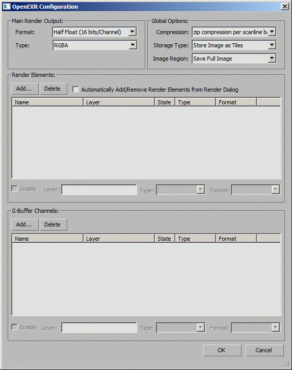

The following methods give access to the Format and Type settings in the Main Render Output group of controls of the OpenEXR Output Settings dialog.
The following methods give access to the Compression, Storage Type and Image Region settings of the OpenEXR Output Settings dialog.

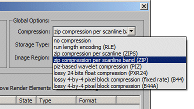

<integer>fopenexr.getCompression ()
Returns an integer corresponding to the selection index of the Compression drop-down list.
Please see the table below for possible values.
Note that the selection index is 0-based.
<bool>fopenexr.SetCompression <integer>compression
Sets the Compression drop-down list to the item specified by the integer argument.
The possible values are:
Code |
Compression Type |
0 |
No compression |
1 |
Run-length encoding (RLE) |
2 |
ZLIB compression, one scanline at a time |
3 |
ZLIB compression, in blocks of 16 scanlines |
4 |
PIZ-based wavelet compression |
5 |
Lossy 24-bit float compression |
6 |
Lossy 4-by-4 pixel block compression |
7 |
Lossy 4-by-4 pixel block compression (fixed rate) |

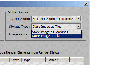

<bool>fopenexr.getSaveScanline ()
Returns true if the Storage Type is set to "Store Image as Scanlines", false if it is set to "Store Image as Tiles".
<bool>fopenexr.setSaveScanline <bool>saveScanline
Sets the Storage Type to "Store Image as Scanlines" if the argument is true.
Sets the Storage Type to "Store Image as Tiles" if the argument is false.

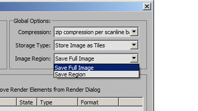

<bool>fopenexr.getSaveRegion ()
Returns true if the Image Region drop-down list is set to Save Region.
Returns false if the Image Region drop-down list is set to Save Full Image.
<bool>fopenexr.setSaveRegion <bool>saveRegion
Sets the Image Region option to Save Region if the Boolean argument is true.
Sets the Image Region option to Save Full Image if the Boolean argument is false.

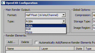

0 - RGBA
1 - RGB
2 - Mono
3 - XYZ (G-Buffer Channels only)
4 - XY (G-Buffer Channels only)
5 - UV (G-Buffer Channels only)
<bool>fopenexr.setLayerOutputType <integer>layer <integer>type
Sets the output type of the layer specified by the first argument to the value of the second argument.
When the first argument is specified as 0, the Main Render Layer's type will be set.
Possible values of the second argument are:
0 - RGBA
1 - RGB
2 - Mono

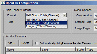

<integer>fopenexr.getLayerOutputFormat <integer>layer
Returns the output format for the specified layer.
Possible values are
0 - FLOAT32
1 - FLOAT16
2 - INT32
<bool>fopenexr.setLayerOutputFormat <integer>layer <integer>format
Sets the output format of the layer specified by the first argument to the type specified by the second argument.
When the first argument is specified as 0, the Main Render Layer's format will be set.
Possible values for the second argument are
0 - FLOAT32
1 - FLOAT16
2 - INT32
