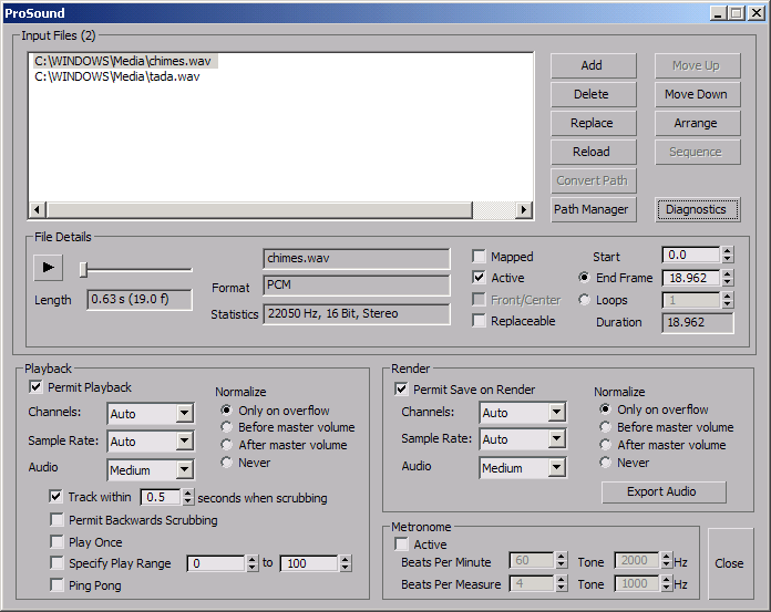

<boolean>prosound.append <filename>AudioFile
Loads the specified file and appends it to the list of audio tracks. The argument must be the full name of a valid audio file.
Equivalent to using the "Add" button in the ProSound UI.

<boolean>prosound.replace <index>Track <filename>AudioFile
Replaces the audio file at the specified index. The first argument is the Index of the file to replace, the second argument is the full file name of a valid audio file to replace with.
Equivalent to using the "Replace" button in the ProSound UI.

<boolean>prosound.ReloadAll()
Reloads all audio files in ProSound. Returns true if the reload is successful, false otherwise.
EXAMPLES:
prosound.append"C:\\WINDOWS\\Media\\chimes.wav"--adds a file
--> true
prosound.append"C:\\WINDOWS\\Media\\tada.wav"--adds another
--> true
prosound.numtracks() --check the number of tracks
--> 2
prosound.delete 1 --deletestrack 1
--> true
prosound.replace 1 "C:\\WINDOWS\\Media\\notify.wav"
--> true
prosound.numtracks() --get the number of track safter deleting 1
--> 1
prosound.maxtracks() --see how many tracks are supported
--> 100
prosound.reloadall() --reload all tracks
--> true
Working With Tracks
<boolean>prosound.active <index>Track
Returns true if the specified indexed track is active, false otherwise.
<boolean>prosound.SetActive <index>Track <boolean>ActiveState
Sets the active status of the specified track. Returns true if successful, false otherwise.
EXAMPLES:
prosound.active 1 --see if track 1 is active
-->true
prosound.setactive 1 false --turn it off
-->true
prosound.active 1 --see if it is on or off now
-->false
prosound.setactive 1 true --turn it back on
-->true
filename>Name <index>Track
Returns the name of the file for the specified track.
<integer>prosound.SampleRate <index>Track
Returns the sample rate of the audio track.
integer>prosound.channels <index>Track
Returns the number of audio channels for the specified audio track.
EXAMPLES:
prosound.name 1 --get the name of track 1
-->"C:\WINDOWS\Media\notify.wav"
prosound.SampleRate 1 --get the sample rate of track 1
-->22050
prosound.channels 1 --get the channels of track 1
-->2
time>prosound.start <index>Track
Returns the start frame number for the specified indexed track.
<boolean>prosound.SetStart <index>Track <time>StartFrame
Sets the start frame of the specified indexed track. Returns true if successful, false otherwise.
time>prosound.end <index>Track
Returns the end frame number for the specified track.
<boolean>prosound.SetEnd <index>Track <time>EndFrame
Sets the end frame of the specified track. Returns true if successful, false otherwise.
<boolean>prosound.Shift <index>Track <time>Frames
Shifts the start and end frames of the specified track by the specified amount. Returns true if successful, false otherwise.
<boolean>prosound.ShiftAll <integer>Frames
Shifts the start and end frames of all audio tracks by the specified amount. Returns true if successful, false otherwise.
time>prosound.filelength <index>Track
Returns the length of the specified audio file (in frames). Note that this is the file length, not the track length. So, if the file is 120 frames long, but the track has a start and end frame of 0 and 150, 120 and not 150 is returned. Use prosound.end() and prosound.start() to get the track length.
Equivalent to the "Duration" value in the ProSound UI.
EXAMPLES:
prosound.start 1 --get the start frame of track 1
-->0f
prosound.end 1 --get the end frame of track 1
-->18.9625f
prosound.filelength 1 --get the file length of track 1
-->40.5875f
prosound.setstart 1 10 --sets the start frame of track 1to 10
-->true
prosound.setend 1 123 --sets the end frame of track 1 to 123
-->true
prosound.start 1 --check the new start frame of track 1
-->10f
prosound.end 1 --check the new end frame of track 1
-->123f
prosound.shift 1 50 --shift both start and end by 50 frames
-->true
prosound.start 1 --check the shifted start frame of track 1
-->60f
prosound.end 1 --check the shifted end frame of track 1
-->173f
prosound.shiftAll -50 --shift all tracks back 50 frames
-->true
