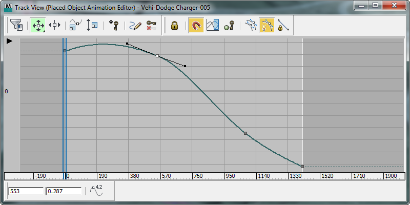

The Placed Object Animation Editor is a greatly simplified version of the standard 3ds Max
Track View window. It is configured specifically to display only placement information relating to the currently selected object. When the current object selection changes, this panel closes automatically.
Interface
The Placed Object Animation Editor displays motion as a series of function curves on a graph. Motion in 3ds Max is defined by a series of
animation keys, and 3ds Max automatically calculates interpolated values between each key to produce a completed animation.
The Placed Object Animation Editor interface consists of toolbars and a
Key window. There is also a moveable time ruler.
The Key (Curve) window
Each function curve displayed in this window represents the interpolated animation assigned to one of the four standard Civil View object-placement parameters:
Station, expressed as a percentage distance along the parent shape between 0.0 and 1.0
Horizontal Offset from the parent shape
Vertical Offset from the parent shape or parent surface
Rotation
Each square box along a curve represents a single
animation key. You can moved, add, and remove keys, or adjust their tangents. Each modification to an animation key instantly affects the overall animation of the selected object.
Keys are displayed in gray unless you select them for editing. In this case, they are displayed in white.
The vertical axis of the graph represents one or more of the following parameters, depending on which function curves are currently displayed:
Percentage distance along the parent shape
Horizontal or vertical offset from the parent shape or surface
Rotation
The horizontal scale represents the total number of frames available in the current visualization scene.
