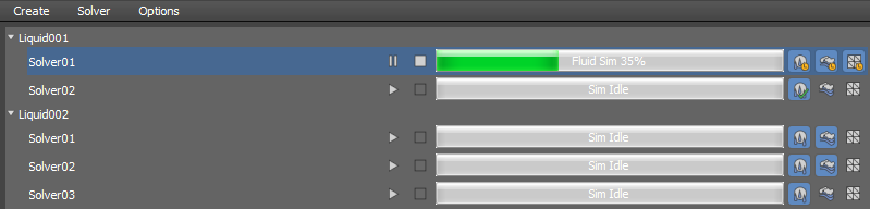

Interface
Management System Area shown with two liquid objects and five active solvers.
Menu bar
Use the Menu bar to manage objects, solvers, and caches, as well as change the window layout and monitor the simulation.

Solver Area
Use the Solver Area to manage liquids and solvers, start and stop solves, monitor sim progress, and select simulation components.
