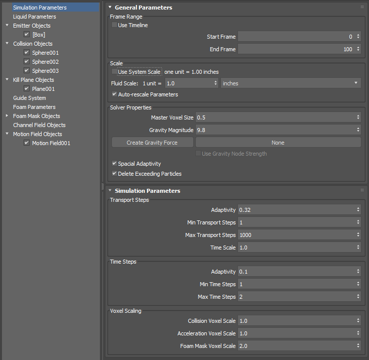

Use the Solver Parameters panel to configure parameters for each solver in the simulation.
- Simulation Parameters
- Sets top-level simulation parameters such as scale, master voxel size, and gravity settings, as well as transport and time steps.
- Liquid Parameters
- Sets the liquid properties for each solver and applies presets.
- Emitter Objects
- Lists and configures the parameters for the emitters in each solver. To turn off a specific emitter object, deselect its checkbox. The enabled or disabled state is saved per solve.
If all emitters are off and a solve is started, a warning dialog will appear, asking you to turn on at least one emitter.
- Collision Objects
- Lists and controls the parameters for collision objects added to each solver. To disable a specific collision object, deselect its checkbox. The enabled or disabled state is saved per solve.
- Kill Plane Objects
- Lists added kill plane objects added to each solver. To disable a specific kill plane object, deselect its checkbox. The enabled or disabled state is saved per solve.
- Guide System
- Configures guides.
- Foam Parameters
- Configures the foam properties for each solver.
- Foam Mask Objects
- Lists and configures objects added as foam masks for each solver. To disable a specific foam mask object, deselect its checkbox. The enabled or disabled state is saved per solve.
- Channel Field Objects
- Lists and configures channel field objects added to each solver. To disable a specific channel field object, deselect its checkbox. The enabled or disabled state is saved per solve.
- Motion Field Objects
- Lists and configures motion field objects added to each solver. To disable a specific motion field object, deselect its checkbox. The enabled or disabled state is saved per solve.
