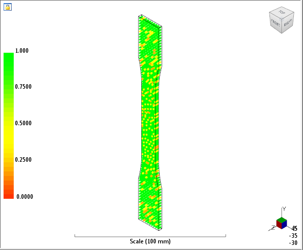

  1. Click Home > Preview > Mapping Suitability Plot. The mapping suitability plot provides an indication of how well Moldflow results will map to the structural model. Refer to the Mapping Suitability section of the User's Guide for additional details.
    From the mapping suitability plot above, we can see that most of the model is shaded green, indicating there is sufficient mesh refinement to map results.

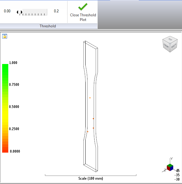

  2. Drag the arrows on the threshold scale to identify areas where potential mesh refinement may be necessary.
    The image above shows there are no major potential problem areas for mapping results.
  3. Click Close Threshold Plot to return to the Home tab.
