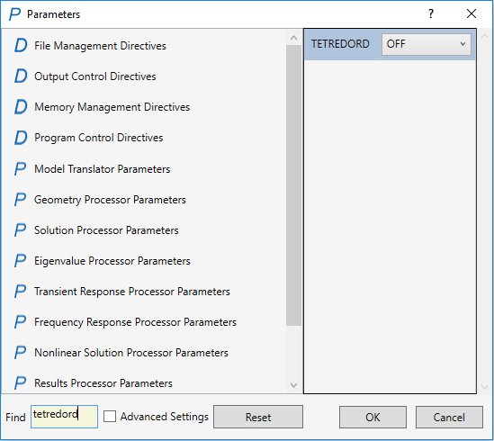

  5. The MATXM entry, which defines the Advanced Material Exchange material, requires that reduced integration is turned off. To do so:
  6. In the project tree, double-click Parameters .
  7. Type TETREDORD in the Find field.
  8. Set TETREDORD to OFF in the drop-down menu.
  9. Click OK.
