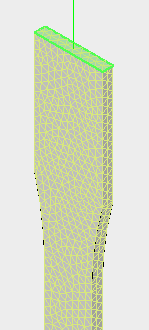

When enforced motion loads are applied as displacements, Nastran In-CAD requires that a constraint is applied in the direction of the displacement load. To create this constraint load:
  1. Click Constraints .
  2. Select the top surface of the coupon with the applied displacement load (face <1>).
  3. Make sure only the Ty component check box is enabled.
  4. Click OK.
