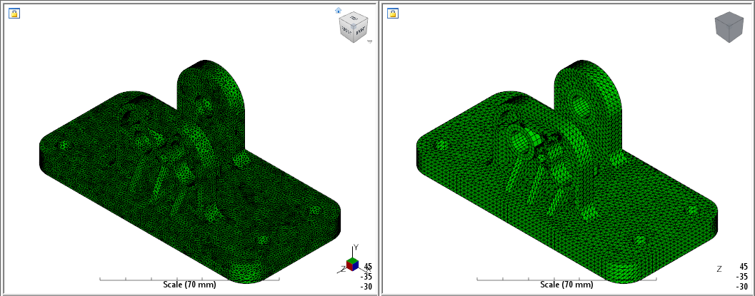

Our next step is to pair the Moldflow study of the pedal base with the corresponding part in the structural assembly.
  1. Click (Hone > Information Pairing > Part Mapping).
  2. When the Part Mapping dialog appears, locate the base.sdy file. Once selected, you will see a preview of the pedal base geometry that you can use to verify the correct part was chosen. Click Continue.
  3. After you select the new study file, you will see a preview of the structural assembly in the Structure Mapping dialog. Select the pedal_base body and click OK.
  4. Click OK in the Part Mapping dialog.
  5. Click OK if notified that this part does not have a .ws3 file associated with it.
