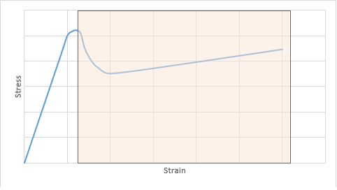

Ductile materials are those that exhibit a large, elongated stress-strain curve (large strains at failure). The plot below shows an example of a ductile material response.
The material model used in Advanced Material Exchange works best for materials that experience failure at relatively low strain. Very ductile materials will not be represented well using the existing material model. Advanced Material Exchange does not consider the region beyond the ultimate stress during the material characterization. This is shown as the shaded region in the plot above.
